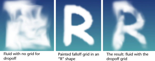

In the following images, the letter “R” is made using Fluid Effects and then it fades/simulates away like a cloud dispersing. Turbulence is used in the fluid volume to push it around. The falloff grid cuts out an “R” shape no matter where the density moves.

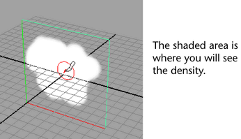

To display a falloff for Fluid Effects
See To paint falloff for Fluid Effects or To use a curve within a container to create falloff for Fluid Effects.
The Paint Fluids Tool settings window appears.
Before painting, be sure to set the falloff display settings as in To display a falloff for Fluid Effects.

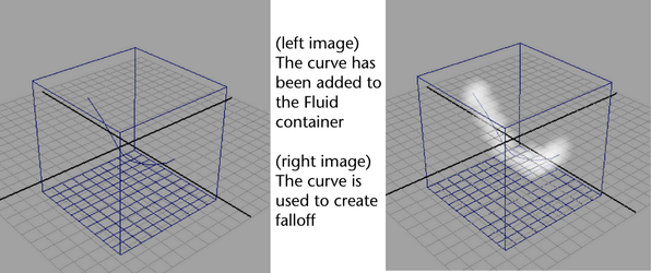

The Set Fluids Contents With Curve Options window appears.
The curve now represents the falloff shape.
