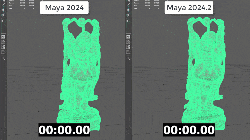

ReForm update
Note: Elapsed time in Maya 2024.2 video is 1 minute 58 seconds
Retopologize's base algorithm, ReForm, has been updated, resulting in improved performance and stability. While the performance boost may vary depending on the input mesh, processing times are now up to 30% faster.

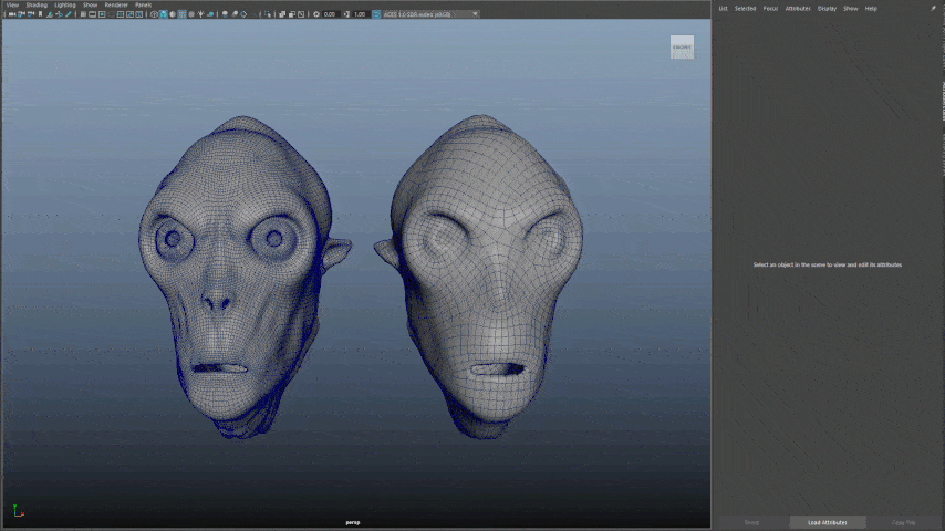

Feature Preservation and Symmetry
Model provided by: Christoph Schädl
Previously, Retoplogize's Symmetry options did not respect any of the Feature Preservation methods (Hard Edges, Edges by Angle, Edge Component Tags). Now, you can use Symmetry together with the Feature Preservation options to produce reliable results. See Preserve areas of a retopologized mesh and Retopologize a mesh with symmetry for more information.
