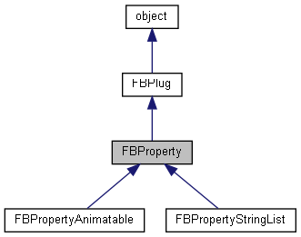

b>Property: Action Action property to trigger function. More...
#include <pyfbsdk_generated.h>

Additional Inherited Members | |
Public Attributes inherited from FBPlug | |
| str | ClassGroupName |
| ClassGroupName of the object. More... | |
| int | TypeInfo |
| TypeInfo. More... | |
