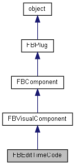

#include <pyfbsdk.h>
Public Member Functions | |
| FBEditTimeCode () | |
| Constructor. More... | |

| FBEditTimeCode | ( | ) |
Constructor.
| FBEvent OnChange |
Event: Timecode changed.
| FBTime Value |
Read Write Property: Current timecode value.
