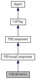

Vector edit widget. More...
#include <pyfbsdk.h>
Public Member Functions | |
| FBEditVector () | |
| Constructor. More... | |
