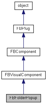

Folder Popup (for selecting a directory). More...
See samples: RenderLayers.py, BatchExportCharacterAnimationTool.py, RenameFirstTakeOnMultipleFiles.py, FBFolderPopup.py.
