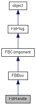

FBHandle class exposes the Handle object of the application. More...
This is a terminal class and should not be used as a base for a new class.
