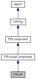

List of items. More...
#include <pyfbsdk.h>
Public Member Functions | |
| FBList () | |
| Constructor. More... | |
| bool | IsSelected (int pIndex) |

| FBList | ( | ) |
Constructor.
Returns whether or not the item pIndex is currently selected.
| pIndex | Index to see if select or not. |
Set the current selected state of item at pIndex to pSelected.
| pIndex | Index to affect item at. |
| pSelected | State to set item at pIndex to. |
