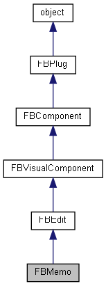

Multi-line text input. More...
#include <pyfbsdk.h>
