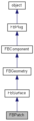

Patch class. More...
#include <pyfbsdk.h>

Public Member Functions inherited from FBSurface | |

Public Member Functions inherited from FBGeometry | |

Public Member Functions inherited from FBComponent | |
