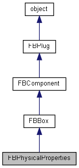

Base class for physical properties attach to a model. More...
#include <pyfbsdk.h>
Public Member Functions | |
| FBPhysicalProperties (str pName) | |
Public Member Functions inherited from FBBox | |
