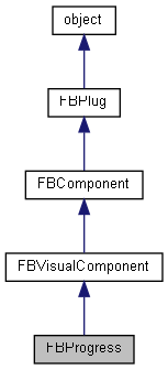

Progress bar.b>Property: Base property class. More...
See samples: 3dsMaxBipedTemplate.py, MirrorPoseOverTime.py, FBProgress.py.
A property is a holder for function callbacks into the internals of the application.You cannot instantiate FBProperty objects. To reference a property: Use an instance of an FBComponent object. The methods FBComponent::PropertyCreate and FBComponent::PropertyRemove can be used to modify an object's set of properties. When accessing a FBProperty object via its containing object, you can get or set (assuming it is not read-only) its value directly, for example in Python: myObject.Visibility = True. FBPropertyManager exists in all FBComponent objects, and contains an array of all the registered properties. Use FBProperty::Find to find a property by name. When accessing a property reference directly, its value is obtained via its 'Data' member.
To see how to create a custom property in Python, see CustomProperty.py.
| FBProgress | ( | ) |
Constructor.
| ProgressBegin | ( | ) |
Start progress, must be called before set Text & Percent property.
| ProgressDone | ( | ) |
End progress, must be called to reset progress bar UI to normal status after finishing the task.
| bool UserRequestCancell | ( | ) |
Return true if User is pressing and holding "ESC" key to request the cancellation.
Must be called in between ProgressBegin()/ProgressDone().
| str Caption |
Read Write Property: Caption to be displayed for progress bar.
| int Percent |
Read Write Property: Percent completed for the operation. Must be used called in between ProgressBegin()/ProgressDone()
| str Text |
Read Write Property: Text to display on progress bar. Must be used in between ProgressBegin()/ProgressDone()
