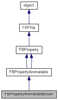

#include <pyfbsdk.h>
Public Member Functions | |
| str | EnumList (int pIdx) |
Public Member Functions inherited from FBPropertyAnimatable | |
