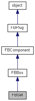

Objects Set class. More...
#include <pyfbsdk.h>

Objects Set class.
This class is an interface to manipulate object sets in the scene. Note: an item cannot be in two FBSet objects at once. Also, an FBGroup cannot contain FBSet objects, although an FBSet object can contain an FBGRoup.
| int Contains | ( | FBComponent | pComponent | ) |
| FBDelete | ( | ) |
Virtual FBDelete function.
| Select | ( | bool | pSelect | ) |
Select.
| pSelect | If true, set contents will be selected. |
| FBListComponent Items |
List: Items in the set.
| bool Pickable |
Read Write Property: Controls if objects in the set are pickable.
| bool Transformable |
Read Write Property: Controls if objects in the set are transformable.
| FBAnimatableBool Visibility |
Read Write Property: Visibility of set (animatable).
