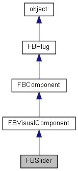

Slider. More...
#include <pyfbsdk.h>
Public Member Functions | |
| FBSlider () | |
| Constructor. More... | |
Public Member Functions inherited from FBVisualComponent | |
| FBVisualComponent () | |
