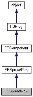

Spreadsheet row.
| FBSpreadRow | ( | FBSpread | pParent, |
| kReference | pRow | ||
Constructor.
| pParent | Parent spreadsheet. |
| pRow | User-defined reference to assign to row. |
| bool EditCaption | ( | ) |
Edit the row caption.
This will initiate the UI edit of a row caption.
| Remove | ( | ) |
Remove (destroy) row.
| str Caption |
Read Write Property: Caption to display with row.
| FBkReference Parent |
Read Write Property: Parent of row (reference).
| bool RowSelected |
Read Write Property: Is row selected?
| bool RowVisible |
Read Write Property: Is row visible? Set to true to show the row, false to hide the row.
