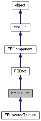

Public Member Functions inherited from FBBox | |

Public Member Functions inherited from FBComponent | |

Public Attributes inherited from FBBox | |

Public Attributes inherited from FBComponent | |

Public Attributes inherited from FBPlug | |
