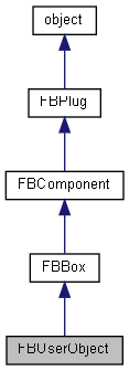

#include <pyfbsdk.h>
Public Member Functions | |
| FBUserObject (str pName) | |
| Constructor. More... | |
