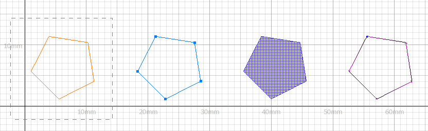

To view slice bounding box, path corners, slice filling, and path directions
You can switch these elements individually per slice stack. As such, their display toggles are only available through the slices' context menus.
  1. Right-click the slice stack you want to change the display of.
    Tip: Have multiple slice stacks selected beforehand to change the visualization for all stacks at once.
  2. From the appearing context menu, choose any of the options Show bounding box, Show points, Show filling, Show directions.
From left: Bounding box, corner points, highlighting, and hatch directions. Note the scale.

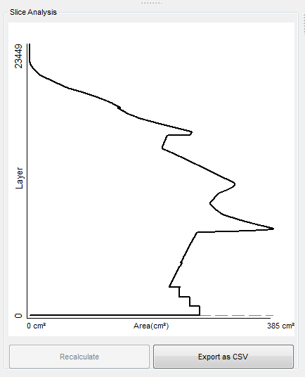

To view area statistics over all layers
Once the Slices section contains slices you can display a graph showing the distribution of area occupied by closed contours. It shows the same value as the context view for Area.
Toggle the statistics view in the main menu through View > Show slice statistics.
The areas of the individual slices, graphed across all involved layers, for the Cartoon House part from the part library
Some actions change the total amount of area covered, such as scaling, adding or removing a slice stack, or point reduction. In such cases, a recalculation is required. However, as this can take a while, it is not done automatically.
Exporting the slice statistics to CSV produces a listing of each slice with its area.
Note: This graph is available in certain machine workspaces. The graph is called and updated only from the respective button in the machine workspace's active context view.
