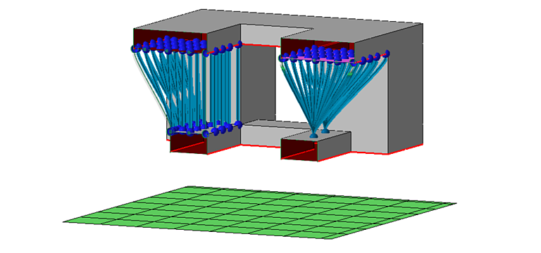

Specify points where bar supports should attach at their lower end
Creating part-to-part support by running an action set up to target specified anchors (right)
Using target anchors
Targeting specific anchors requires two things.
- The anchors
- A script containing the action
Area with bar support that has
Project bar set to
To selected anchor.
- Use the commands from the main menu to place and select anchors on the part surface.
- With the target anchors selected, run the script action directly.
To have all eligible bars targeted
- In the context view, select the
Scripts tab.
- From the dropdown menu, select the script with the action you set up earlier. Double-click the
Apply icon to run the action.
To have only those of a specific cluster targeted
- Right-click the cluster.
- Choose
Call action on cluster.
- From the appearing dialog, find the script with the action you set up earlier, and select the action.
- Click
Execute
