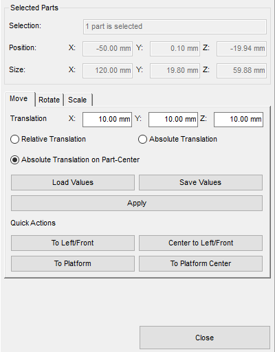

The commands Move and Rotate are located in the main menu, in the Arrange category; the Scale command sits in Modify.
They are also available in the context menu of a part, both in the project tree and the 3D display.
Once called in either way, the context view switches to show the appropriate input fields and buttons. Here you can make use of shortcut buttons that send the selected part to the platform center, or fill the rotation angle field with a value.
Numerical controls and presets for transforming a part (shown here: moving) are conveniently available in the context view.

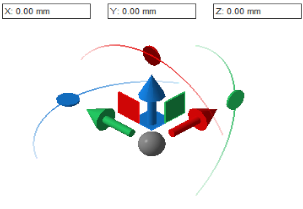

Gizmo
A set of manipulation handles, across Autodesk software known as gizmo, appears while the transformation controls are active. The gizmo itself does not have controls for scaling, however.
You can switch the gizmo to become active as soon as a part is merely selected, using View > Show Gizmo.
Note: Some actions would interfere with an always-active gizmo, such as free cutting. In those cases, Netfabb notifies you: Gizmo temporarily disabled.
Every element of the gizmo provides interactive control.
Note: While they appear together, the gizmo and transformation controls in the context view are independent, moving the gizmo or changing values in the context view are not specifically synchronized.
