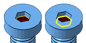

Highlighting errors in general draws a thicker line, and also draws it always on top.

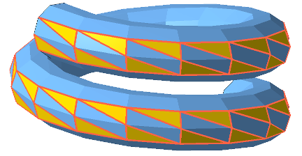

. Triangles too narrow can cause
Optimization Utility, which operates on a tetrahedral volume mesh to lattice or to lightweight parts, to retriangulate the input surface as this could otherwise produce less reliable results. You cannot control this remeshing in any way except choosing not to, so it can be beneficial to test for this during repair and possibly remesh the part before sending it over.
Triangles with their smallest inner angle being smaller than a threshold are highlighted.
