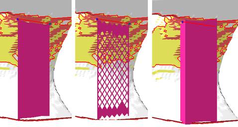

Polyline type
Sets the type of polyline.
From left: Open wall, open structure, solid wall
