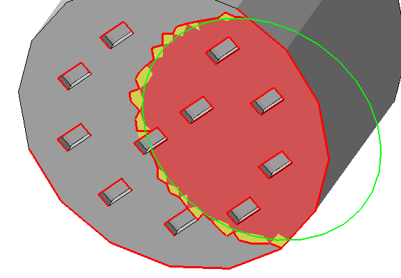

Mark cluster manually holds the settings for manually selecting triangles to be supportable clusters
  • Brush size: Adjusts the brush size for when Mark cluster manually is active
  • Edge threshold: When manually marking clusters, triangles under the brush but beyond a convex edge remain unmarked when its angle is sharper than this threshold. Also applies to flood-filling of surface patches.
The edge threshold makes marking large areas with many small perforations much easier.
Note: Manual marking and automatic detection cannot be combined. Also, the critical and non-critical angle for manual marking is fixed at 90°.
