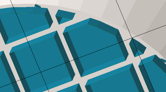

Volume supports fill shadow volumes of downskins: The volume formed by projecting the downskin area towards the platform is filled with more or less dense, "sponge-like", volumetric support structures.
Left: Solid volume supports divided into fragments. Right: Volume supports built from a patterned structure.

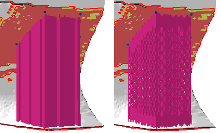

Switch the support walls between Closed volume (solid) and Structure.
  • The fragments that make up closed volume supports are essentially box-shaped columns. They are closed on all sides, even at top and bottom. The connection with the part surface is facilitated by small pins.

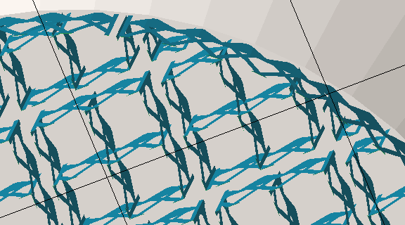

  • Structure supports are, by default, akin to patches of intersecting wire fence. Also, the entire cluster area is enclosed by a single wall along the circumference, ie. the cluster's contour.
Applied default closed-volume supports. A cut via clip plane demonstrates the cluster's contour, the fragments' cross section, the terminating surface at the top, and the stand-off against the part surface.
Applied default Structure supports. Note the gap in the circumference.

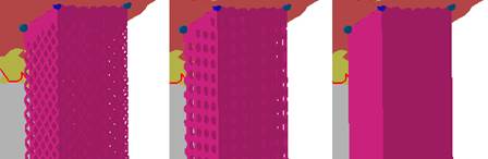

Structure pattern
Switch between Wired wall (left), a Punched plate (middle), and Plain (right) to determine the wall pattern of volume supports.

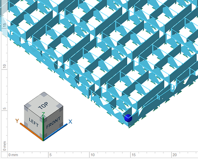

Raster
The raster is built up from intersecting polyline walls and fills the actual volume of volume support.

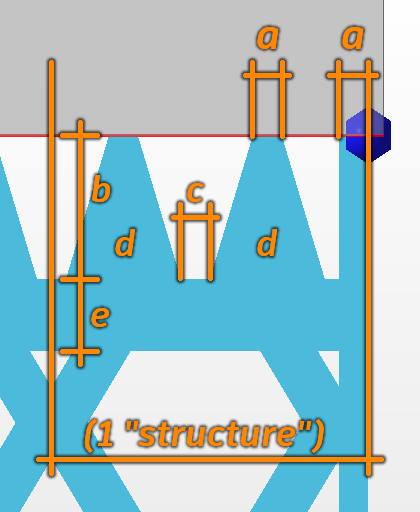

Type of connection
Select from: Strip, Trapoid, Breaking Points, Triangles.
  • Strip: A continuous band connecting to the part all along its upper edge
  • Trapoid: Triangles with truncated tips
  • Breaking points: Like trapoid, but with another, inverted row of trapoids stacked on top, forming X-shaped connections
  • Triangles: Triangles that simply terminate in pointy tips, for very delicate support attachment
Connection width a
Connection properties
  • Does not apply to Strip.
  • For Triangles, this only applies to the vertical line at the beginning for the polyline, or contour.
  • For Breaking Points, this is the "waist" of the X-shaped connections.
The width of the vertical strip on the far right can be overridden. See Structure Properties > Border width.
Connection height b
  • For Strip, b and e are simply cumulative.
Pin distance c
Pins per structure d
Distance connection to structure e
