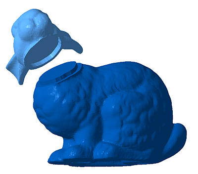

Groove joinery
Groove joinery creates a single matching plug-and-socket arrangement of surface features that follows the contour of the cut.
Groove joinery settings
- Wall thickness (wt): Thickness of the rim
- Gap (g): Peripheral clearance between the two parts, seen along the parallel to the cut
- Height (h): Width of the nose
- Distance (d): Axial clearance between the parts, seen along the perpendicular to the cut
Plug-and-socket features to reassemble sections after a cut
