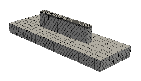

For each layer, the first bead is deposited along the +x direction, then the second bead is deposited in the−x direction. The radius of the melt pool is 1 mm, its power is 450 W, and the translation speed is 10 mm/s. The hatch spacing between the two beads is 2 mm. The ambient temperature during the process is 30.5oC. The substrate is constrained as simply supported. The thermal and mechanical response of this process is to be calculated using Local Simulation with adaptive meshing. The mesh, shown in Figure 2, is created automatically using the *AUTM and *SBXY cards. *OSIG is used to designate the writing of Cauchy stress results.
Figure 2: LENS part discretized by 8-node linear hexahedral elements. Dummy boundary conditions, materials, and properties must also be applied.
