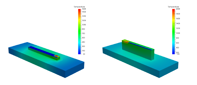

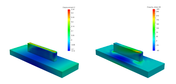

The results can be viewed in Simulation Utility for Netfabb or ParaView by importing the CASE files. Thermal results during deposition are shown at two different increments in Figure 3. Post-process distortion and a sample stress result is shown in Figure 4.
Figure 3: Temperature results (oC) at increments 1000 and 4000
Figure 4: (a) Post-process distortion results, warped, (b) Post-process XX direction Cauchy stresses, warped 1X
