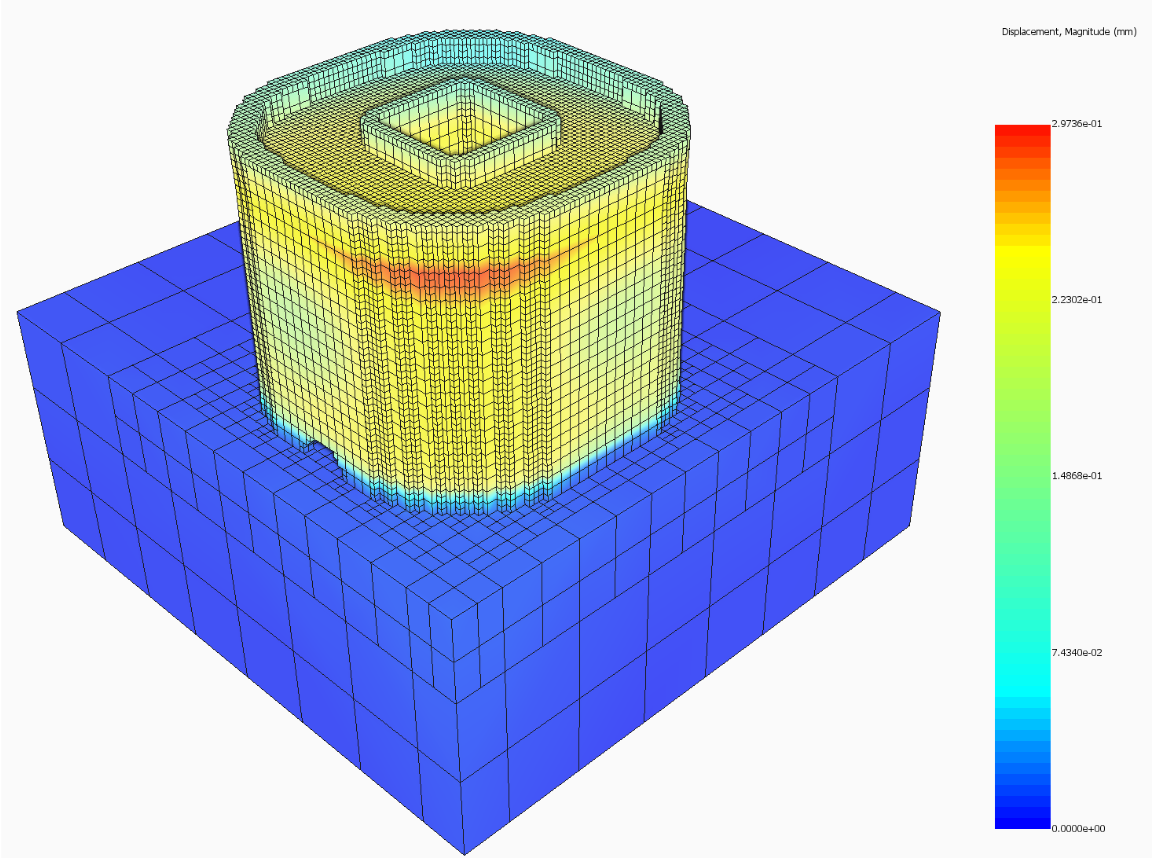

Results as displayed after simulation without compression
Results displayed as loaded from compressed archive
