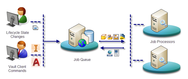

How It Works
Jobs are submitted to the job server when:
Multi-Site Support for the Job Server
The Job Server supports multi-site environments by logging into a specific server and only processing jobs that are associated with that server. In the illustration below, any job processor that logs into Site B will only process jobs that are at Site B. The same happens for Job Processors in Site A.
