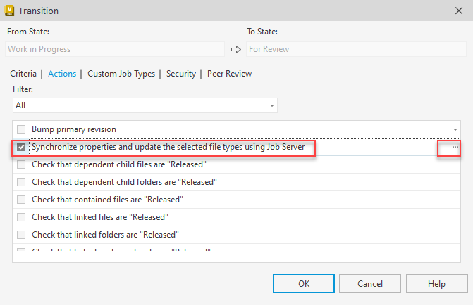

    There are five options in the Transition dialog: Criteria, Actions, Custom Job Types, Security, and Peer Review.
  6. Select the Actions tab.
  7. Select the check box for Synchronize properties and update the selected file types using Job Server from the Available Actions list.
  8. Click on the ellipses (...) button and select the file type.
    Note: Selecting this option from the list does not automatically select the check box as well. Make sure to select the check box beside the option too.
  9. Click OK to save your changes.
