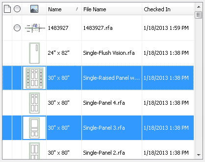

Grid
The grid displays the Revit Family types that meet the current search parameters. Select a Revit Family type to load that family type.
Note: If you select a Revit Family file, the Search Conditions List updates to include the family file name (i.e., File:FileName.rfa).

Select a Family Type from a File
The Revit rfa file is added to the Search Conditions List and the grid displays all Family Types associated with the selected file. A list of parameters available for the family types in the Grid is displayed in the Parameter List.

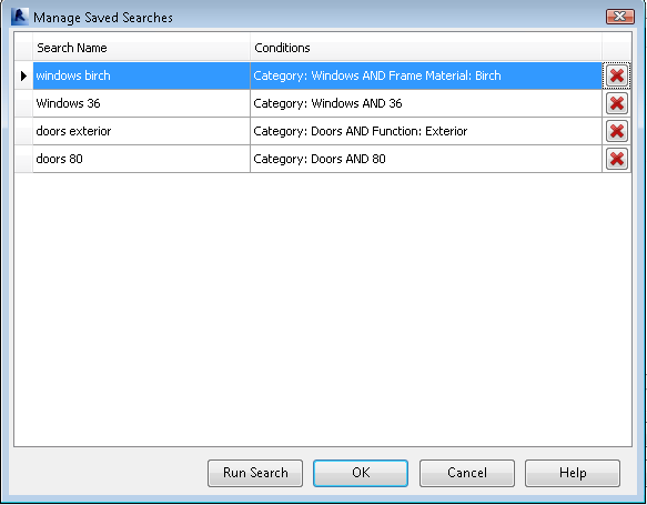

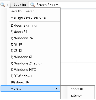

Save a Search
The search configuration is saved.
Load a Search
The Manage Saved Searches dialog opens.
beside that search row. Click Run Search to run the selected search.
Click Cancel at any time to exit without saving.
