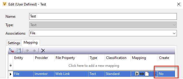

Warning message: "Some properties could not be updated for the copied files."
There are mappings between Vault properties and the file properties. Copy Design attempts to synchronize properties but the action fails if the property does not exist on the files in Vault (Vault property mappings are set to Create = "No").
To resolve the property update failure warning:
Note: If you do not want to add a specific property to the copied file (for example, property is specific to the assembly files and the copied file is a drawing) create a separate category for that type of files that is not linked to that property.
