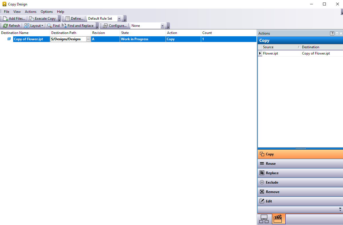

Copy Design is now a modeless dialog with a toolbar: It can now remain open while you use the Vault client for other commands as well as add files to be copied.
The Copy Design feature creates a copy of the design with the same structure as the source files. In the Copy Design dialog, you can choose which parts of an existing design to copy, reuse, reuse branch, replace, exclude, or detach.
