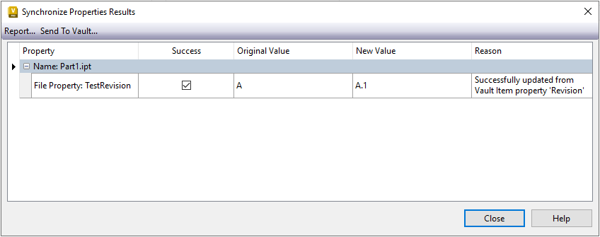

  7. Select the File, click Change Category in the Vault ribbon, and change the category from 'Base' to 'Engineering'. You will see Part1.ipt is in Revision A and displays properties compliance error in the Project Explorer.
  8. Select the file and click Actions > Synchronize Properties. You will see that there are no changes to the Part1.ipt file property. Part 1.ipt remains at Revision A even if you synchronize properties.
  9. Now, change the Revision for Part1 item to A.1. Then, change the Revision for Part1-MS1 item to A.1.1, and for Part1-MS2 item to B.
  10. Select the file and click Actions > Synchronize Properties.
    The Inventor property (custom property) will always synchronize with Part1 item (which is assigned from the Primary Model State) and thus, TestRevision will revise to Revision A.1 after synchronization. However, the file revision will remain Revision A.
