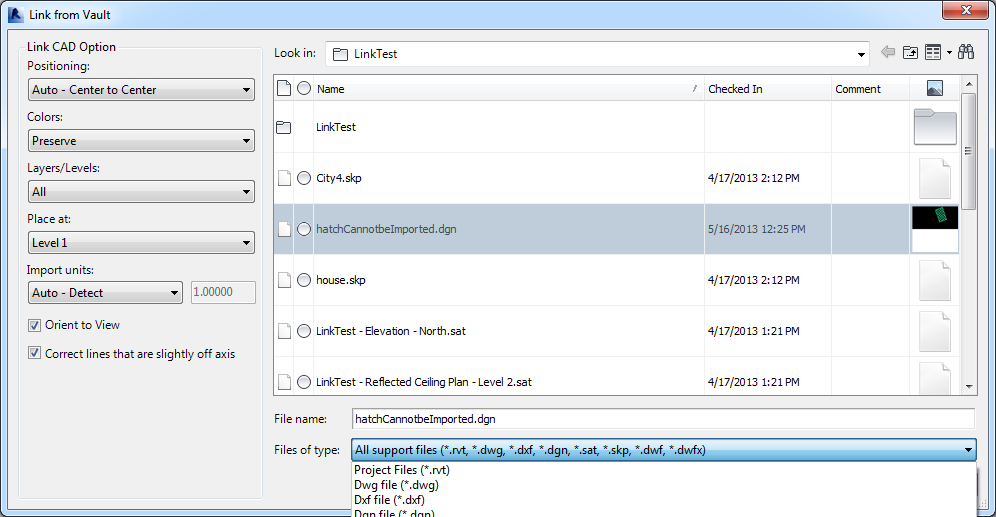

Learn about linking files stored in a vault to the current Revit project.
Link from Vault lets you link a file stored in the Vault to the current Revit Project. The advantage of using the Link from Vault is that there is no need to know where the latest version of the file is. If the latest version is located on the Revit Server, then the Revit Server version is linked too. If the file is a non-work shared file, it is downloaded from Vault and linked to the current project and will continue to be managed by Vault.
You can select a file in Vault to be linked to the current Revit project and specify position options for the linked file on the Link from Vault dialog.
Link from Vault supports these file types:
You can select a positioning preference when you link a file into the current Revit project.
The following table describes the positioning options available for selection.

Worksets
If you are working with linked worksets, all worksets from the work-shared link are loaded and displayed.
