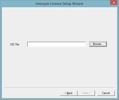

The Apply Update Page of the License Wizard is used to upgrade a dongle from a .v2c upgrade file provided by Innovyze.
Licence Setup Wizard - Apply Update page
Enter the path of the .v2c upgrade file or click the Browse button to browse for a file using a Windows Open dialog.
Click Next to apply the update. If the update is successful, the Finish page will be displayed.
