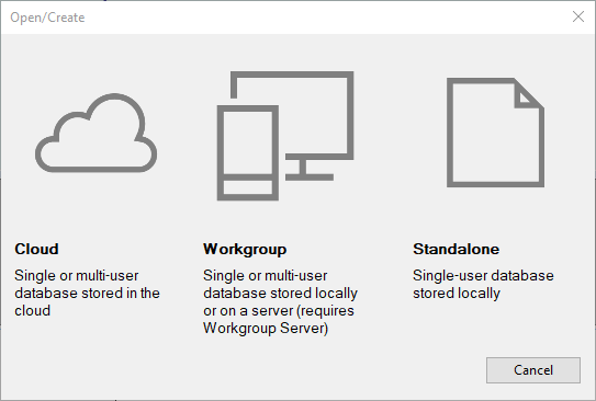

This dialog is used to select which type of database you want to open, create, update, or get the identifier for.
It is displayed when you select:
- Open/Create database or Open another database from the File | Open menu.
- Update database from the File | Database update menu.
The following options available:
- Cloud - Enabled for
Autodesk licenses only. Stores the database in the cloud. This option is available for single or multiple users.
- Workgroup - Stores the database on-premise, either on your local computer or a server. Access the
Workgroup Data Server is required for a workgroup database. This option is available for single or multiple users.
- Standalone - Stores the database on-premise on your local computer. This option is available for only for a single user.
When you select an option, the
Open Database dialog is displayed.
