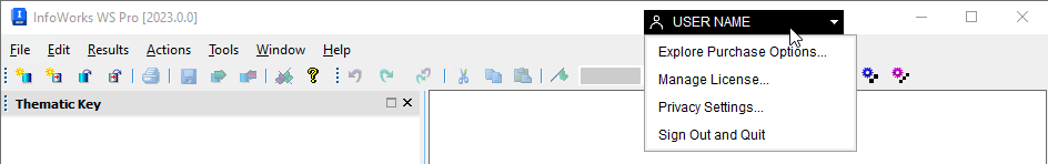

The Autodesk Account menu is available in the title bar of the InfoWorks WS Pro workspace.
) specifying the remaining days before the license expires. This information is also displayed in the start-up dialog.
The following options are available:

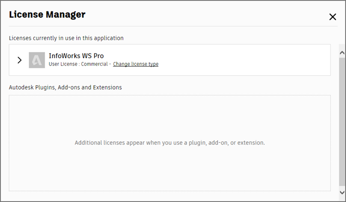

Clicking the Change license type link displays the Autodesk Let's Get Started window, which you can use to switch Autodesk accounts.
Contact Autodesk support if you require assistance.

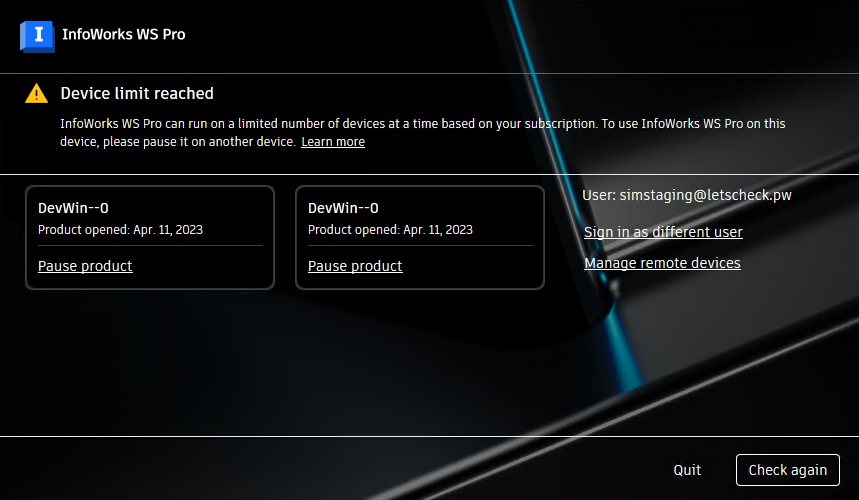

Based on your subscription, InfoWorks WS Pro licenses may only be used on limited number of devices at any one time. When this limit is reached and you try to use the application on another device, a Device Limit Reached dialog is displayed. It lists the devices the application is currently being used on and lets you pause the usage on a selected device so that you can use the license to access the application on the current device. An example is shown below.
Options:
