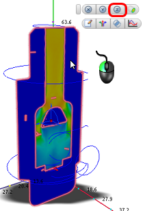

To rotate the plane, left click on it, and click Z from the Context dialog:
You should see this (but without the letters):
What is this image telling you?

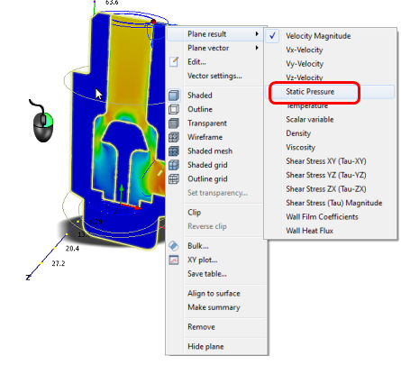

To see the pressure drop through the valve, right click on the plane, click Plane result and Static Pressure:
You should see this:
This plot shows the pressure drop through the valve. Because the pressure is 0 at the outlet, the pressure at the inlet is the overall pressure drop. Note that the pressure dips pretty low as it turns the inside corner near the outlet (position "C" from step 3). Fortunately it's not so low that cavitation is an issue.
