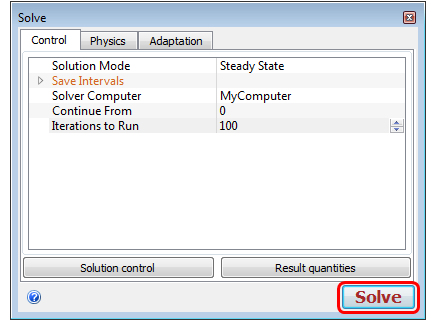

In this step, we start the flow simulation in our valve. The simulation takes about 5-7 minutes to complete after you start the run.
Click Solve from the Setup tab:
The default settings are appropriate for this model, so click Solve to start the simulation.
While it's running, you can see the results as they are computed.
