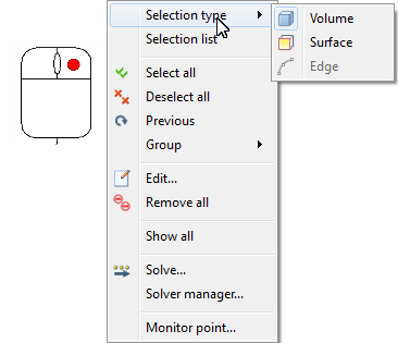

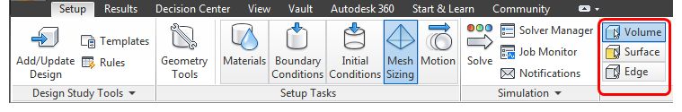

There are times when you will need to change the type of object that can be selected:
From the Setup tab:
From the right click mouse menu:
From the Quick Access toolbar...
The cursor indicates the current selection mode:
Volume:
Surface:
Edge:

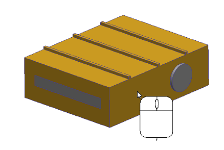

In many cases, it is helpful to hide a part or surface to access an internal component.
To hide an object: Hover over it, and press Ctrl and the middle mouse button:
To select an object and then hide it, left click on it, and click Hide from the context toolbar:
. Note that the part is selected because you left clicked on it. This is useful when you want to assign the same setting to external and internal parts:

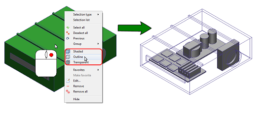

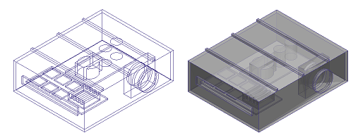

By default, the model appears shaded, like this:
To show the model as an outline or as transparent, select from the Visual Style menu in the Quick Access toolbar:
Alternatively, select from (View tab > Visual Style).
To change the appearance of an individual part, right click on it, and select from the menu:

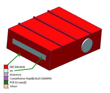

The Design Study Bar shows all assigned settings under the appropriate branch:
Graphical cues and a corresponding legend show where settings are applied:

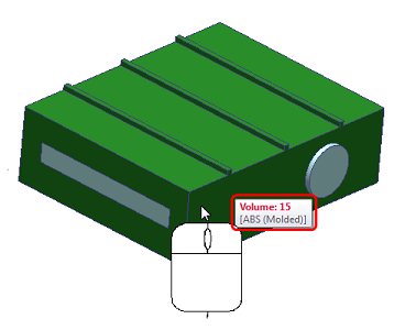

Tooltips show the values of applied settings. Hover your mouse over the part or surface to view the tooltip:
