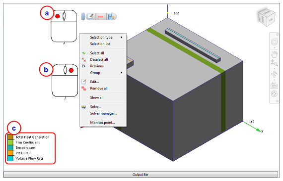

Here are a few important points about the graphics window:
a. Left click = toolbar for applying and removing settings
b. Right click = menu for the current task
c. Use the legend to check your settings.
Note that the left- and right-click commands are also available on the Ribbon.

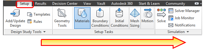

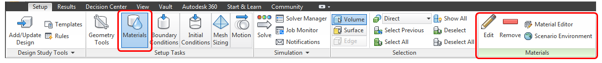

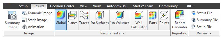

You can do just about everything with the ribbon commands. Here are some things you should know:
To learn more about the ribbon, click here.

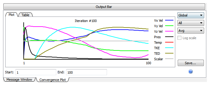

You can use the Output Bar, located below the Model window, for several functions:
To learn more about the Output bar, click here.

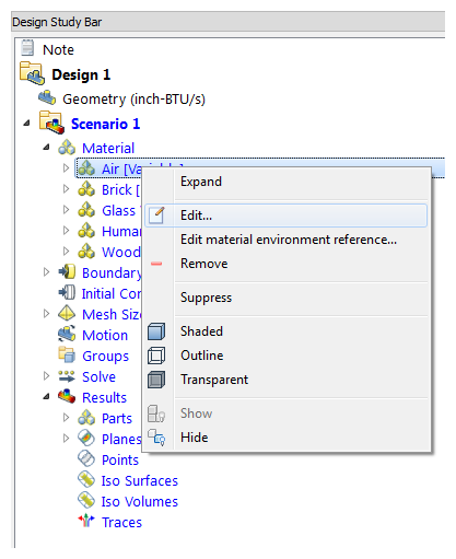

This is the "tree." It lists your settings. You can change almost any setting by right clicking on it.

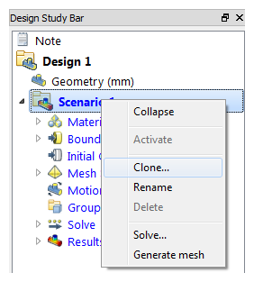

Run multiple scenarios in a design study to vary settings or geometric models. Copy an existing simulation by "cloning" the design or scenario, and modify as needed:
To learn more about the Design Study bar, click here.

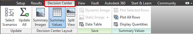

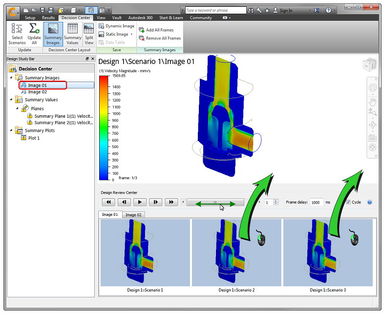

After you have captured summary data, you can manage the data in the Decision Center. Click the Decision Center tab:
The Decision Center appears:

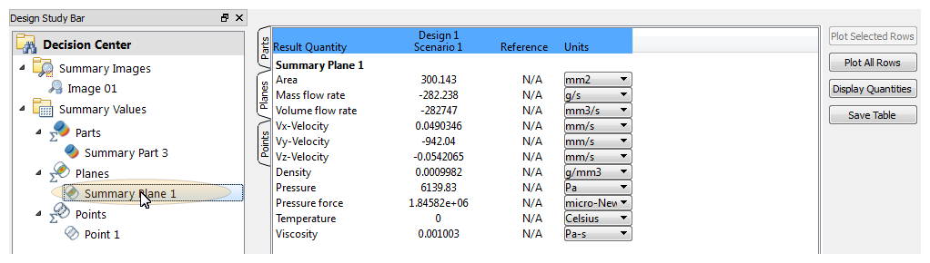

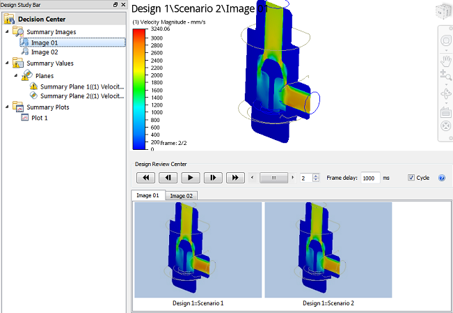

You can use the Summary Value table to review and compare Summary data from the scenarios in the design study:
You can use the Design Review Center to compare Summary Images from all scenarios. This allows direct comparison of results created in a consistent manner.
To view results from each scenario, drag the slider. You can also display results side-by-side with the (View tab > Window panel > Viewports) command.
