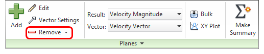

1. To start, click Remove from the Planes context panel.

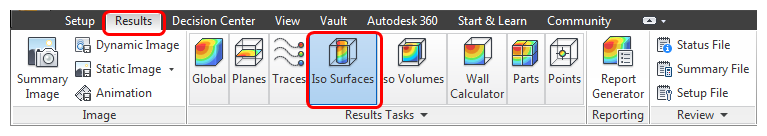

2. Create an iso surface by clicking Results > Results Tasks > Iso Surfaces.

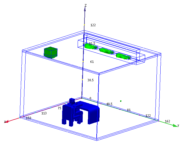

You should see this:
This is a surface with a uniform value. It shows the places in the model that have the same value of velocity magnitude.

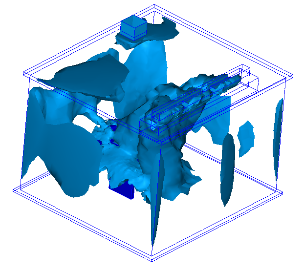

5. On the Iso Surface Control dialog, drag the slider to a quarter of the way from the left end for a more interesting view.
This is a three dimensional view of the flow distribution.
Iso surfaces are a great tool for AEC simulations because they clearly communicate the flow distribution in the space. Results planes capture a two dimensional slice of the flow, but iso surfaces capture the full, three-dimensional view.
In this case, we see that at the specified velocity, a large volume of air moves under the desk and behind the occupant.
