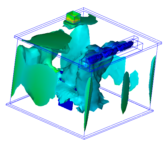

Next, we combine the flow and temperature into a single view:
3. Change the Quantity to Velocity Magnitude.
Drag the slider to the left to see more of the low-velocity flow.
You should see this:
This shows the temperature (the Color by result) everywhere a particular value of velocity magnitude occurs (the iso quantity). As you drag the slider, you are changing the value of velocity magnitude.

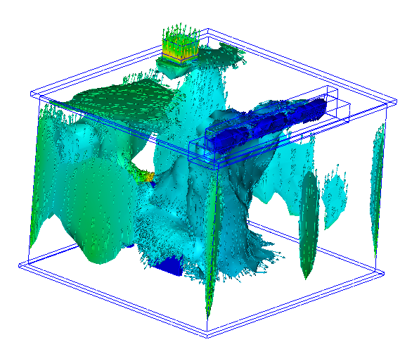

4. To show vectors on the plot, click the Vector settings tab, and select Velocity Vector from the Results menu.
This combined view is a great way to visualize and understand the three dimensional flow and temperature distribution. Notice the thermal plume coming off the occupant. This makes sense because he's warmer than the air around him.
