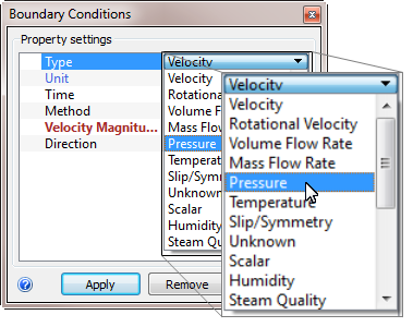

Click Edit from the Boundary Conditions context panel:
On the Type row, select Pressure.
Leave the Unit as Psi and set the Pressure = 0.
Click Apply.
This defines a static gage pressure of 0, which simulates the flow outlet.
