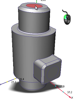

To resume the visibility of all parts, press Ctrl, and middle click anywhere off the model.
Select the inlet face by left clicking on it:

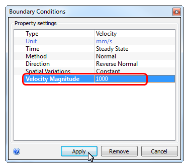

Click Edit from the Boundary Conditions context panel:
On the Velocity Magnitude line, enter 1000. Click Apply:
What it should look like...

For this exercise, we applied a constant velocity. In many valve simulations, either the flow rate or the pressure drop is known. Either condition can be used as necessary instead of a specified velocity. (Just don't apply more than one flow condition to the same inlet.)
