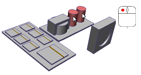

In the step, we apply a heat dissipation to the two capacitors.
1. Select the two capacitors by left clicking on them.
2. Click Edit from the Boundary Conditions context panel:
3. Verify the Type is Total Heat Generation, and the Unit is set to W (Watts).
4. On the Total Heat Generation row, enter 4.
5. Click Apply.
What it should look like...

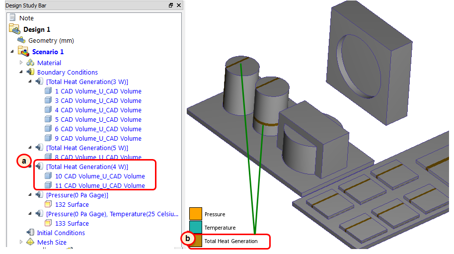

6. To verify that the condition is correctly applied to the capacitors, check the Design Study bar and the colored stripe on the two capacitors.
