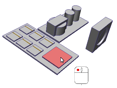

In the step, we apply a heat dissipation to the large chip. The heat sink is mounted to this chip.
1. Select the large chip by left clicking it. To see it, hide the heat sink by holding Ctrl and middle clicking.

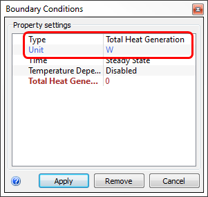

2. Click Edit from the Boundary Conditions context panel:

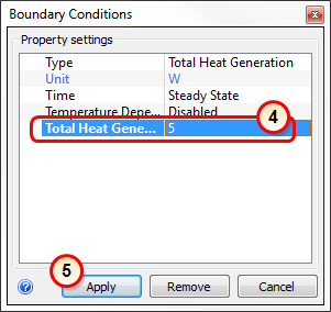

3. Verify that the Type is Total Heat Generation, and the Unit is set to W (Watts).
4. On the Total Heat Generation row, enter 5.
5. Click Apply.

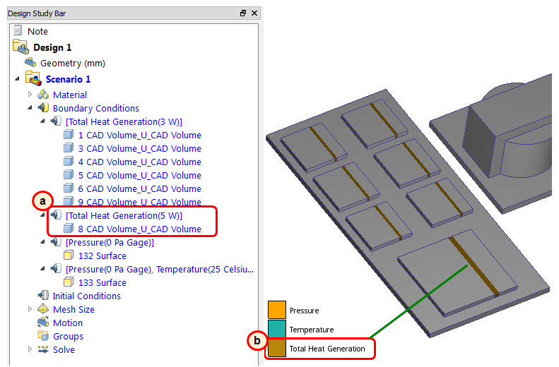

6. To verify that the condition is correctly applied to the chip, check the Design Study bar and the colored stripe on the large chip.
