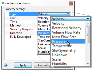

1. Left click on the outlet surface.
2. Click Edit from the Boundary Conditions context panel:

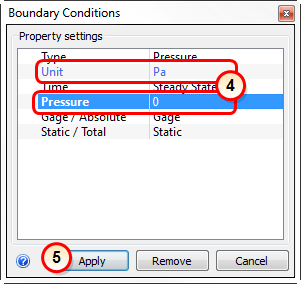

3. On the Type row, select Pressure.
4. Leave the Unit as Pa and the Pressure value = 0.
5. Click Apply.
What it should look like...
